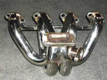

Clipped and trimmed turbos for as far as the eye can see, and bleed valves to tune to the boost levels you want.

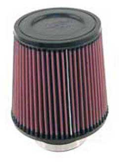

Turbo motors take to free mods like a fat kid on a cupcake too, open elemet filters, removal of all accordian intake hoses/restrictions/air cleaner assy, and exhaust restrictions, underdrive pulleys, sythetics, and ALT draws.

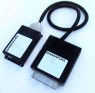

Then of course we can get into personal programming, but that is way down the line from this point:
