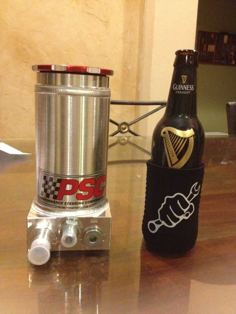

Postby KF5ZXT » Tue Jun 19, 2012 11:09 pm
Wow, the power steering pump reservoir is a bit larger than I had anticipated. :)
