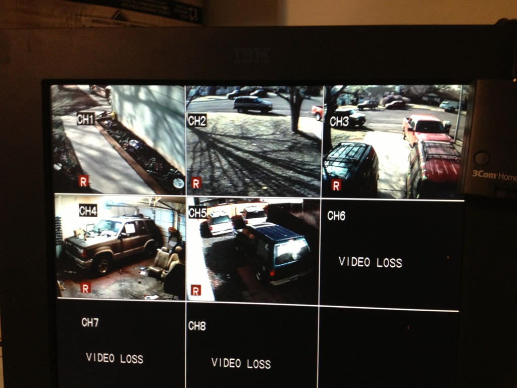

Here is what's been set up so far.

How long is the recording loop?
Re: Garage cam
Postby Kris Guilbeaux » Mon Mar 18, 2013 11:20 am
2weeks

What kind of video quality?
Sent from you guessed it.
Re: Garage cam
Postby nice59fordf100 » Mon Mar 18, 2013 2:34 pm
Right now we are recording with HD1 @ 15 FPS resolution and the cameras are 1/4" CCD with 480 TVL.

Does it give the option to pick up one camera and turn it into the entire screen so you can see more detail?
Re: Garage cam
Postby nice59fordf100 » Thu Mar 21, 2013 9:20 am
yep, sure does. Plus it can sequence through all the cameras, has remote view capability, can backup to a usb thumb drive. It's a pretty ecent system for the price overall.

What was the cost ?

200 for the base system, 75 for the 1TB hard drive (about 14 days total recording time) and about 150 for misc accessories (4 IR illuminators, extra rca cables, 4 microphones, various connectors and couplers)

Fail the cameras don't have built in illuminates?

Actually, all the cameras are double ring 28 led IR. But some areas of the house need extra illumination to proerply light up the scrren at night.
