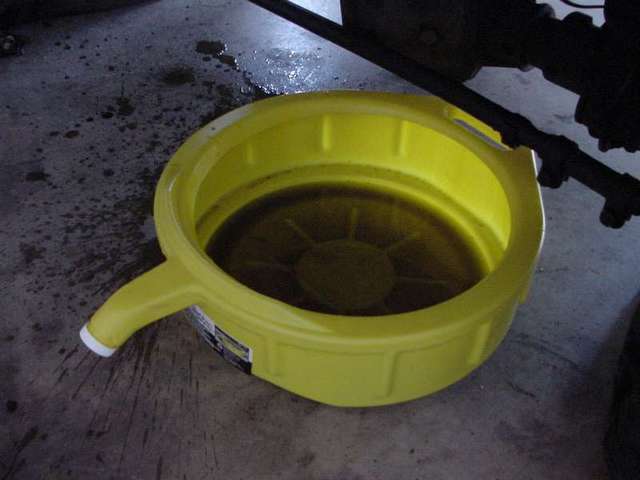

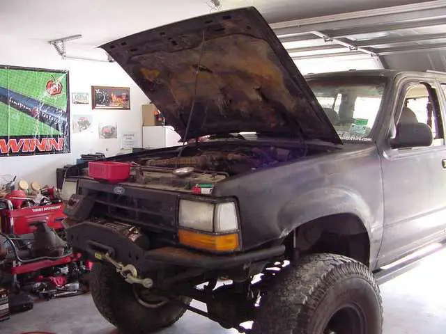

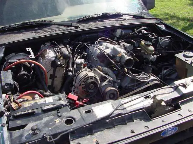

The Patient:

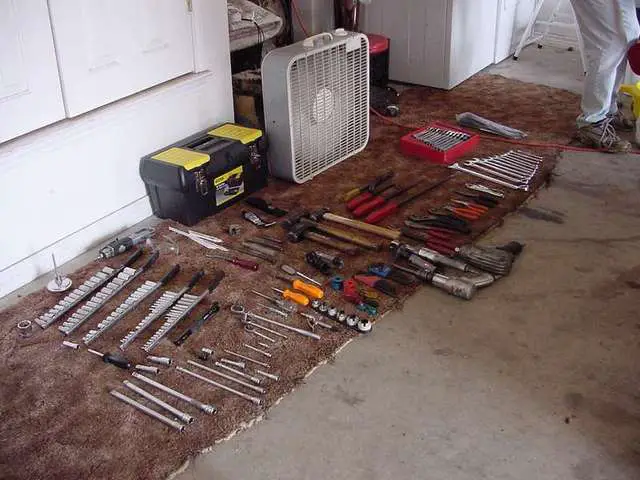

The Tools for Surgery:
And last, but definitely not least....the Demon Technician himself, Dr. SVO :twisted:

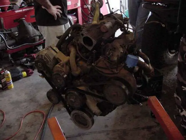

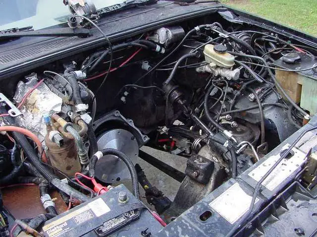

Transmission has been separated from the engine. :o
Postby Stang Girl » Sat Apr 01, 2006 4:55 pm
Spare Parts

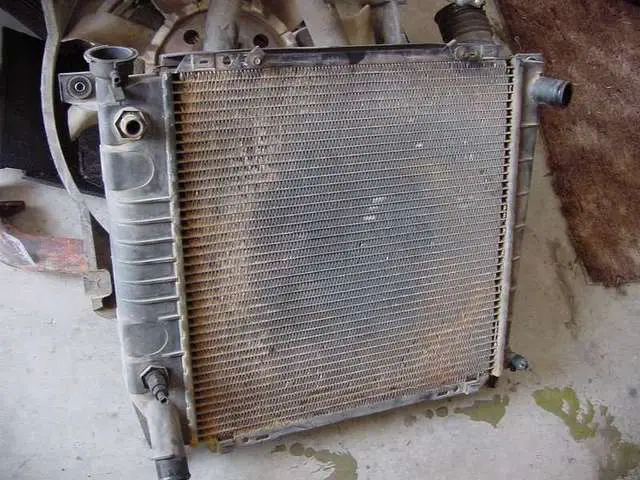

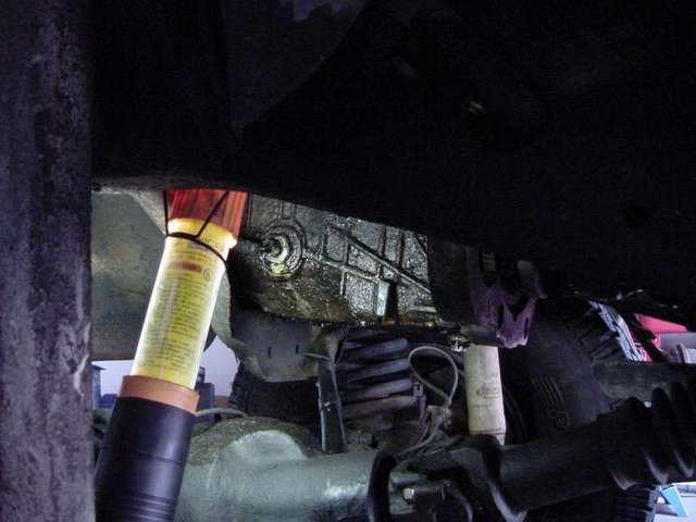

Ewwwww :shock
Randall, was your truck running hot?
Kind of a muddy radiator....
and not too much coolant came out of the system.

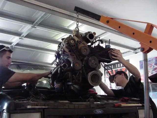

It's Out....
Postby Stang Girl » Sat Apr 01, 2006 6:05 pm
Postby Stang Girl » Sat Apr 01, 2006 6:07 pm

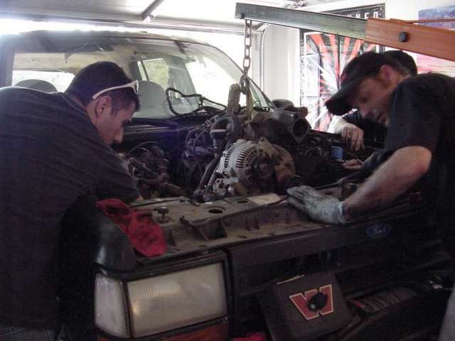

Well, Brandon didn't want to help move some folks, so he decided to come over and help SVO and Zavaral out. :wink
And yeah, they found the rest of your coolant Randall. It was in the motor. :shock

Yes the Beast was low on coolant, no biggie as the motor was to be change anyways, BTW I also noticed the heads had been replaced on the motor that I pulled out.
Other thngs I noticed were radius arm piviot brackets were loose, and a nut missing off the transfer case to transmission, loose shock mounts, worn out bushings on the shocks, and a bunch of icky poo everywhere.

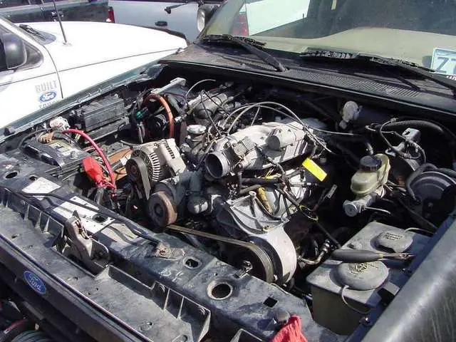

Update...4/2/06
Postby Stang Girl » Sun Apr 02, 2006 12:08 pm

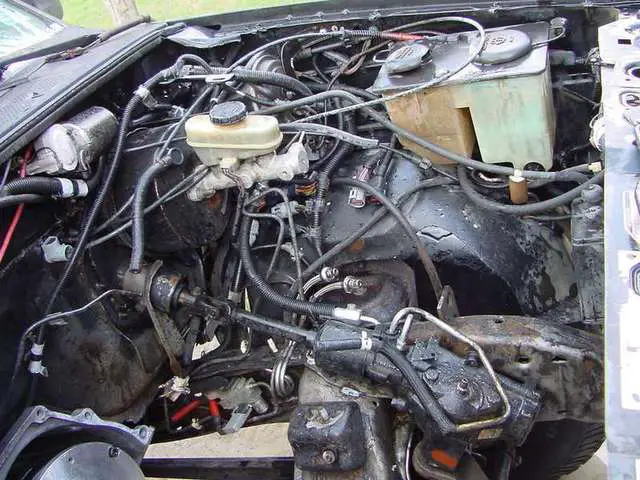

New Engine getting a little TLC. :wink
Engine Bay...
Before: :shock
After: :rockon
More Engine Bay:
Before: :o
After: :cheer
